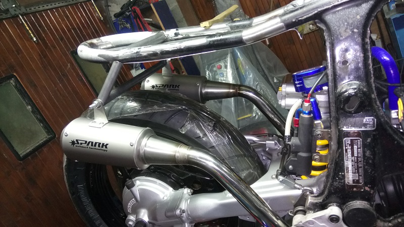

http://www.hondacx.com/images/uploads/marin/DSC_0287.JPGhttp://www.hondacx.com/images/uploads/marin/DSC_0290.JPG
positionnement des silencieux.

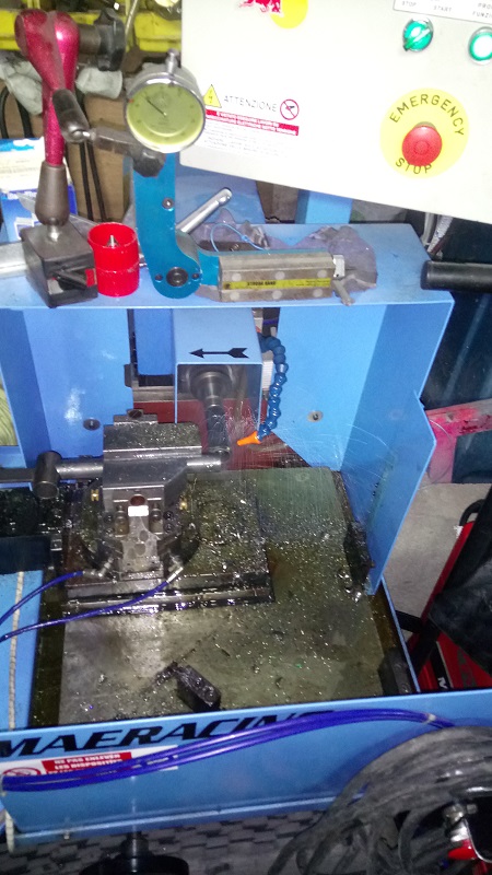

http://www.hondacx.com/images/uploads/marin/DSC_0286.JPGhttp://www.hondacx.com/images/uploads/marin/DSC_0285.JPG
grugeage du tube 25cd4s et fabrication des supports moteurs.
